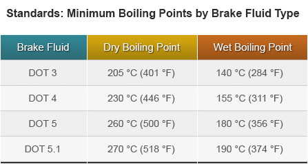

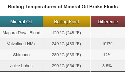

tu pourrais peut être changer de type d'huile minérale ?
"Magura Royal Blood Mineral Oil has a ridiculously low boiling temperature when compared with it's rivals in the industry.
Even LHM+ outweighs Royal Blood with a fluid that has a 107% higher boiling temperature.
The reasons behind this low temperature is unknown, all we know is that Magura Royal Blood
is based on Castrol Vitamol V10 hydraulic fluid".
http://www.epicbleedsolutions.com/blog/dot-brake-fluid-vs-mineral-oil/

Intéressant cette information.
Je vais donc d'abord tester le changement du Vitamol pour une huile minérale de performance supérieure.
