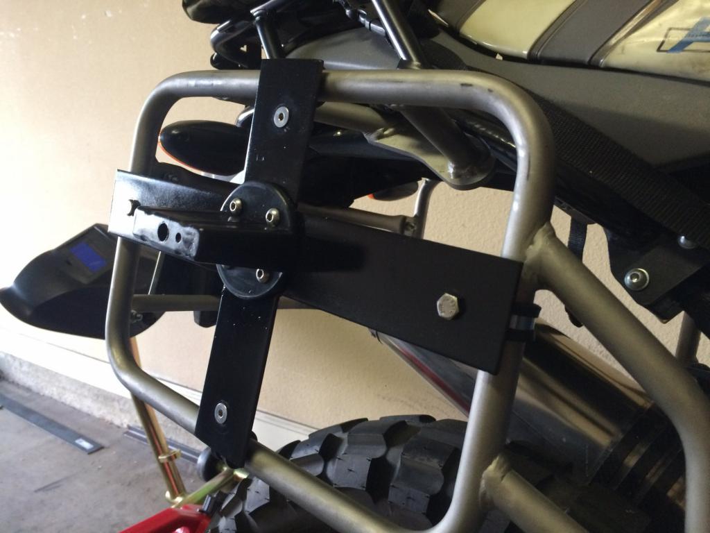

Camel tank : 6 litres
https://camel-adv.com/products/bmw-r1200gs-lc-camel-tank-ct-gsw
seulement compatible avec les supports latéraux & valises Jesse
" We contacted Jesse Luggage Systems and they went to work designing the "Traveler" pannier system.
This pannier system was created specifically to allow mounting a Camel Tank to the R1200GS LC and be able to run the legendary Jesse panniers!"
