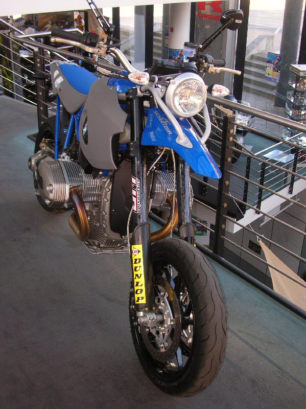

For fast acceleration on the road and track, safe braking is essential - so the second front brake was an important part in the engineers' specifications.
The fully adjustable upside-down fork from WP Suspension with diameter 50mm brings sufficient rigidity and provides a mounting for the 2nd brake.
The 4-piston callipers of the R 1100 S BoxerCup Replica are fitted with adapters and grip the corresponding 320 mm diameter brake discs.
They are activated with a 17mm radial pump from PHOENIX, which is matched by the 16mm radial clutch pump.

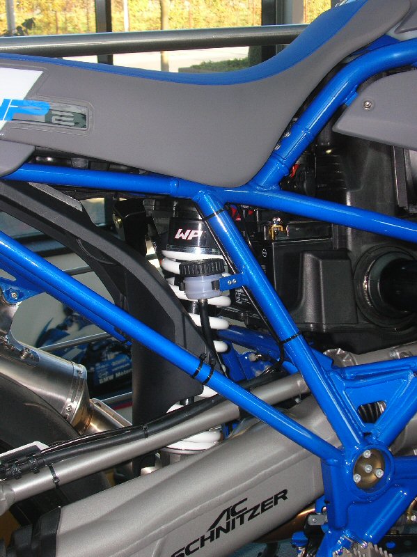

To balance the front wheel guide, the rear spring strut is replaced by a fully adjustable WP Suspension spring strut with higher spring rate.
